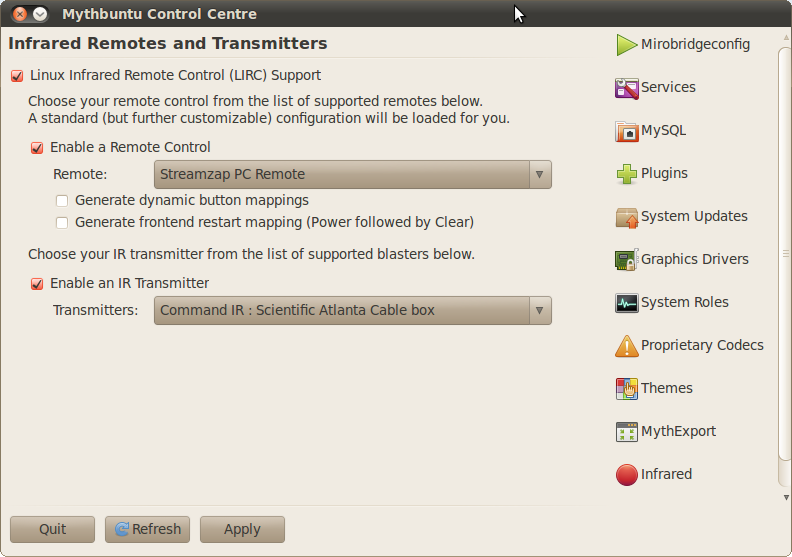

I get most of my content OTA via HD Homerun and antenna in my attic. I'm loving the OTA content but I wanted to get ESPN HD so I picked up an HD PVR 1212 from Amazon for $169.99. I got a Cisco RNG150 settop box from Comcast. I'm new to IR blasting. After searching a bit I get the impression that the Cisco RNG150 is kinda new and unknown. I've tried setting the IR transmitter to a SA cable box but it doesn't change channels. Does anyone have any recommendations on where to start so I can get channel changing working?

Which blaster are you using, the PVR-1212's? If so support is a bit sketchy at the moment. Whatever IR blaster you use make sure it's functioning correctly. I assume you did a search of your STB model & MythTV? If nobody has come up with a working lirc.conf file for that particular model STB then you're going to need create your own. You can record the keys by using the irrecord command. Here are a couple good guides:
