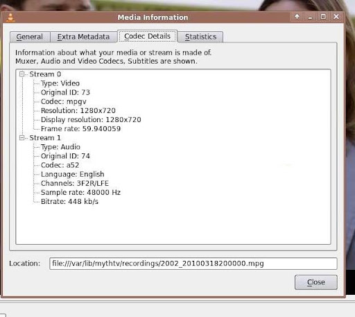

i don't want you to waste too much time one this, it could be something i have done as i am still a Linux noob. i am not sure how to tell what mpg it is. here is what i know and an output from VLC about media info. if there is a command line option i can run for more detail, let me know.
anyway, mythbuntu 9.10, repo PPA enabled , qam256 cable
